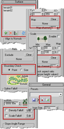

Surfaces
- Multiple surfaces support.
- In absence of area splines, the surfaces are used as scattering areas.
- Density and scale falloff curves by altitude. The curve is applied in the range defined by the Top and Bottom parameters (X=0 is Bottom, X=1 is Top).
- Altitude for limits and falloff is computed in Forest local coordinates, instead Surface coords. This mode is more suitable for multiple surfaces use.
- Overlapping of items at different heights is allowed in Generate mode (using multiple surfaces only).
- All "Get UVW form Surface" parameters have been removed. To disable UVW mapping from surface, set map channel to 0.
- All items that don't intersect with a surface are discarded.
Other
- VRay 2.0 support.
- Rotate and Scale maps.
- Random translation on Z axis.
- Boundary checking with Area splines can work in two modes: 'Point', checking only the item's position, or 'Size', using the item's width and its collision radius.
- Nesting level is considered when evaluating the area splines. Nested include splines are used as exclusion zones and viceversa.
- Presets can be exported and imported to external files. Presets list allows to use longer descriptions.
