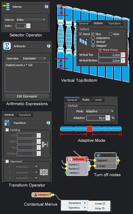

RailClone Pro 2.1.0 beta
Style Editor:
- Style Editor is now integrated within Max. Stay-on-top is not longer needed, all connection issues should be solved.
- Added Selector operator: selects a Segment according to an index.
- Added Transform operator: transform and modify properties a segment (alignment, padding, scale, etc.)
- Added expressions to Arithmetic operator.
- Added contextual creation menu (using right click->Add or dragging links).
- New subtype of Numeric parameter: Boolean (returns 0-1).
- Most of nodes can be turned off (clicking checkbox at right top corner when is selected, or by right click contextual menu). Each node has a specific behaviour when is off.
- Generator->On field is not longer needed and has been removed.
- Alt+Click selects a node and its childrens.
- Added Ctrl+C / Ctrl+V shortcuts for Copy / Paste actions.
- Allowed zoom over 100%. Set zoom limit at Options->Preferences.
- Added Options->Preferences->Rename Segments when Reload (on/off).
- Added Options->Preferences->Show Warning Messages (on/off).
- Exported parameters are highlighted in red color.
- Improved undo/redo.
- Fixed limits of several parameters.
- Fixed: Segments can be connected to exported parameters.
New features and changes:
- New parameter: Style->Geometry->Simple Y Offset mode.
    RailClone uses a sophisticated algorithm to compute Y Offset paths, but it some cases it would not generate a correct result.
   We have included an alternative simpler mode that could solve these cases. Enable it if you get distorted geometry when using Y Offset.
- Added Adaptive mode for Generator->Rules->Default. Bevels are not allowed on this mode.
- Added Adaptive mode for Generator->Rules->Evenly.
- Added Vertical Top/Bottom for Segment->Stepped mode. It works similar to Flat Top/Bottom for Vertical mode.
- RailClone Tools sets Octane "Movable Proxy" property to the instanced items.
- Added support for VRay 3.0 beta.
