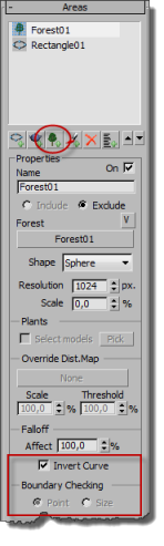

Areas
  • "Bound Checking" now is local for each area.
  • Added "Falloff->Invert Curve". Flips the values of the falloff curves.
  • Added "Object->Scale". Scales the geometry of the referenced object in the Object Areas.
  • New type of Area: Forest. Lets you to use a Forest object as Exclude area. There are two modes to compute the excluding region:
    • Sphere. Uses a virtual bounding-sphere that surrounds each item. The size of the sphere may be scaled using the "Scale" parameter of the area, or modifying the "Collision Radius" parameter in the Geometry List of the excluding Forest.
    • Mesh: Uses the full geometry of each item. This mode may be slower, specially using heavy geometries, but more precise.

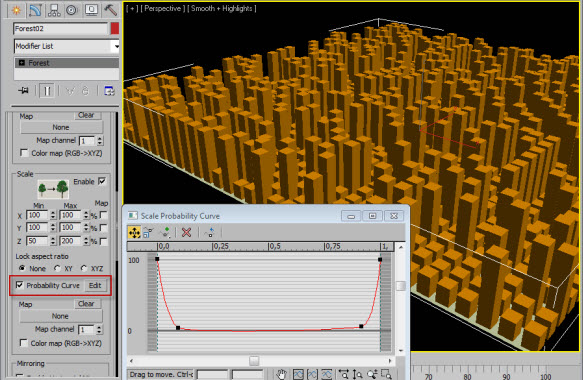

  • Added Probability Curves for Rotation/Scale. Lets you to define the probability of each value in the range (X = Min/Max range, Y: 0-100% probability).

Non-uniform scale distribution
