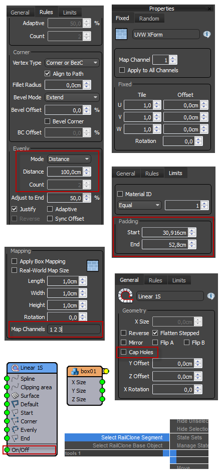

- Added UVW XForm operator. (*)
- Added Export Attributes. This feature allows to export numeric values from nodes. e.g. size of a Segment. To use it: select Segment->right click->Export Attributes.
- Segment->Mapping accepts multiple map channels. Write them separated by spaces (*)
- Segment->Mapping, Material and UVW XForm (*) operators can be used with all render engines and RailClone Tools when Display->Use Instancing Engine is off.
- Added Generator->Limits->Padding (Start/End for Linear, Left/Right/Top/Bottom for Arrays).
- Added two modes for Generator->Rules->Evenly: Distance and Count. Distance works as before, and Count creates a fixed number of elements.

- Added Generator->Cap Holes. It works same as Cap Holes Max modifier but keeping instancing capability.

- Added Segments selector to Quad menu.

- All nodes include an On/Off exportable parameter. This parameter is independent of the clickable On/Off state.
