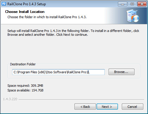

2) Run the installer of 1.x, select Max 2010 and modify the destination folder, i.e. to C:\Program....\RailClonePro1\
