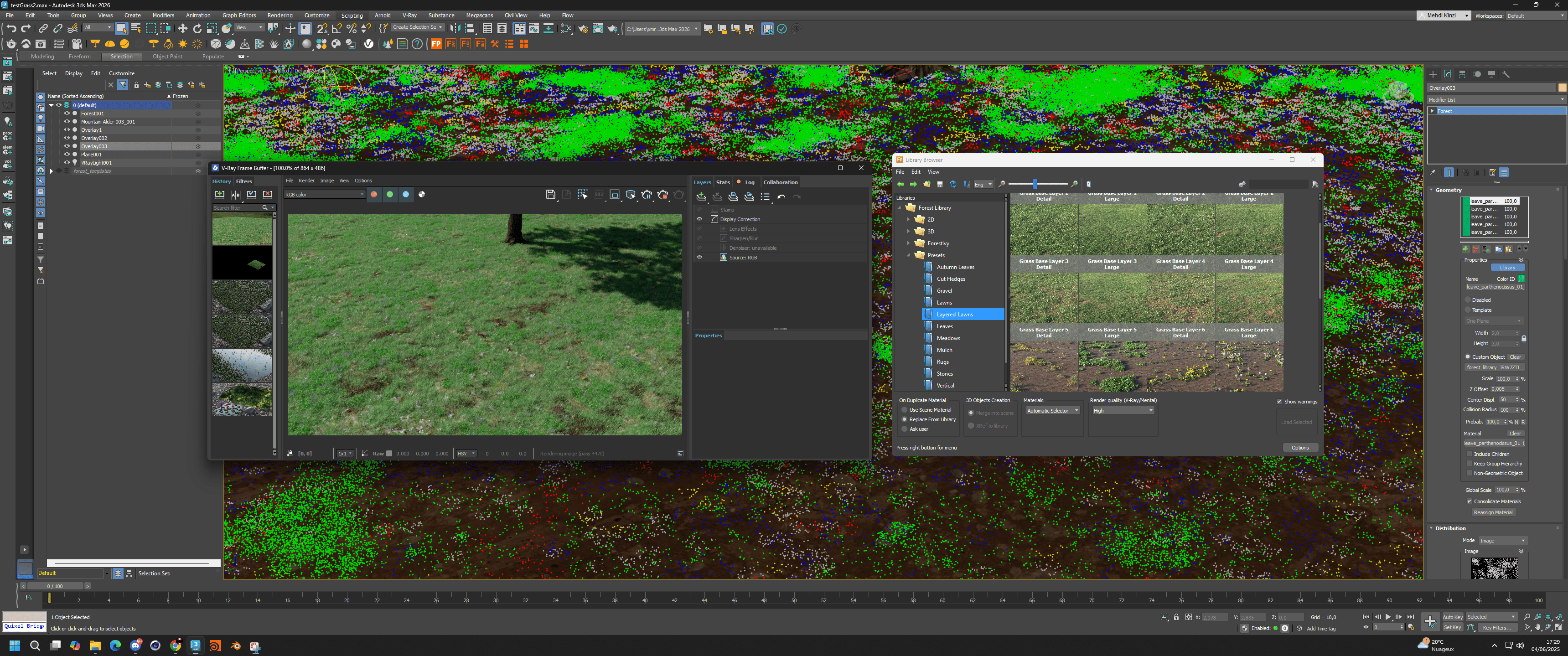

I recently bought Forest Pack Pro and I have a question.
I’m using V-Ray as a render engine, and I’d like to know if the colors in the render view are accurate, because they look different from the thumbnails.
Thank you!
https://image.noelshack.com/fichiers/2025/23/3/1749051174-capture-d-cran-2025-06-04-172914.png
(I can't attach an image "External Error)

Hi,
The final look and tonality largely depend on the lighting setup and the render engine being used. However, a quick way to fine-tune the result is by using Forest’s Material > Color Correction tools. These allow you to adjust Hue Shift, Saturation, and Brightness for all 'Forest Color' maps applied to the object. I hope this helps.
