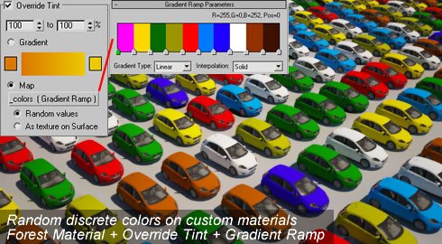

If you are using 3D people, one alternative to add more variation, would be to change their cloths randomly using Forest Color. You would tint it from a discrete range of colors, or use several textures. Something as this:

That method won't work for me unless i want to custom make 70 texture map variations for each colour change - the tex maps includes skin, shoes, hair etc so randomizing the colour would affect the whole person :)
If the maps were setup differently your method would improve things though.
