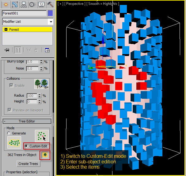

This is the normal behavior, and it seems to work fine here. If you switch from Generate to Custom Edit mode, the distribution of items is preserved, and the items removed by collisions are not included. Instead, switching from Custom Edit to Generate mode recreates the object, loosing all changes of the edit mode.
If you are experiencing a different result, please send us a sample scene to check it.

Sorry, but i don't understand.  Currently, if you switch from Generate to Custom Edit, the distribution of items is freezed, including collision detection. You can see it on my images...
Would it be that it is working differently in your scene ? Please, post some screenshots if this is the problem.
