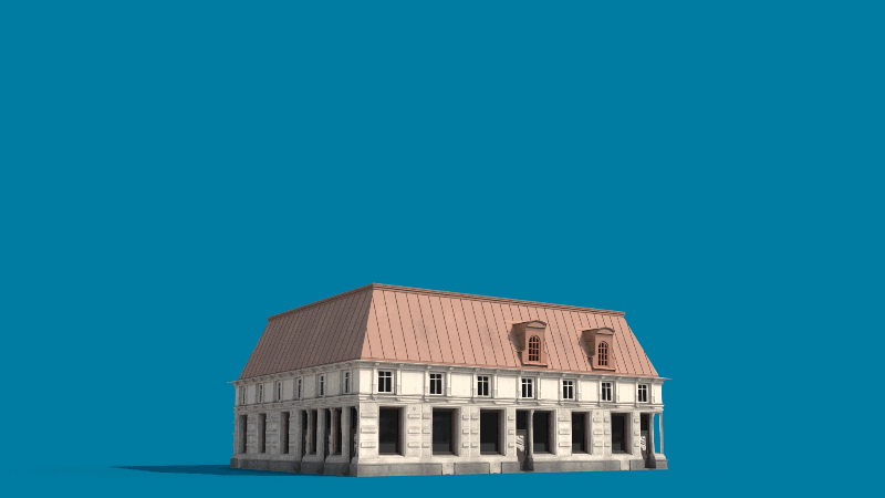

I can confirm that it's on our wishlist, but at present, the only way that's possible at the moment is using a macro. You can find it in Transform > Y Adaptive.
Here's a demo from the RC4.3 release notes
A simplified scene file is also attached in case it's of help.
Paul
