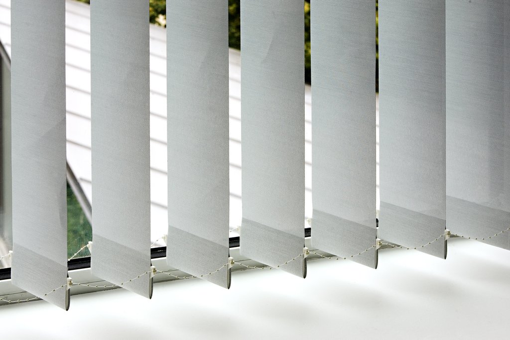

To get this perfect it will need another kind of stuff :
a small balls chain that goes from vertical louvres to another, at the bottom of them...
Really not sure if it is possible, even for rotation and for opening...
maybe i should try to surface-attach nodes to the parts and to dynamically create a rope from them, using MassFX...
I don't know...
For the rotation effect, it is i think more easy : but we need to convert some rotation angle to some complex X & Y movement...
For the opening, we could use a one-dir scale, but the little spheres would be flatten...

« Reply #3 on: March 11, 2014, 03:54:51 pm »
Hi,
Check out the attached file. When fully open the chains with balls should rotate to follow the louvres. They do scale when the blind is closed too, but as you pointed out this deforms the balls in fairly unnatural ways.  I can't really think of a way around that in RailClone at the moment. As a compromise you could do something similar but with the chain in a straight line instead of a series of curves.
To calculate the XY movement of the chains I used the Sin and Cos functions found in expressions option of the Arithmetic operator.
Here's the file  - https://dl.dropboxusercontent.com/u/218877678/iToo/support15rev2.max. The generators I've added are at the bottom of the node tree.
