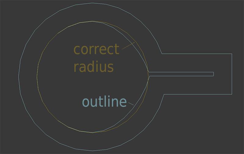

By the way, Max always had a problem with this type of bezier corners - try making an offset (outline) on such spline and you will get something like this:
Maybe it's related.
