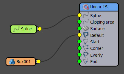

I'm running into an issue with a very simple RC object (all settings are default):

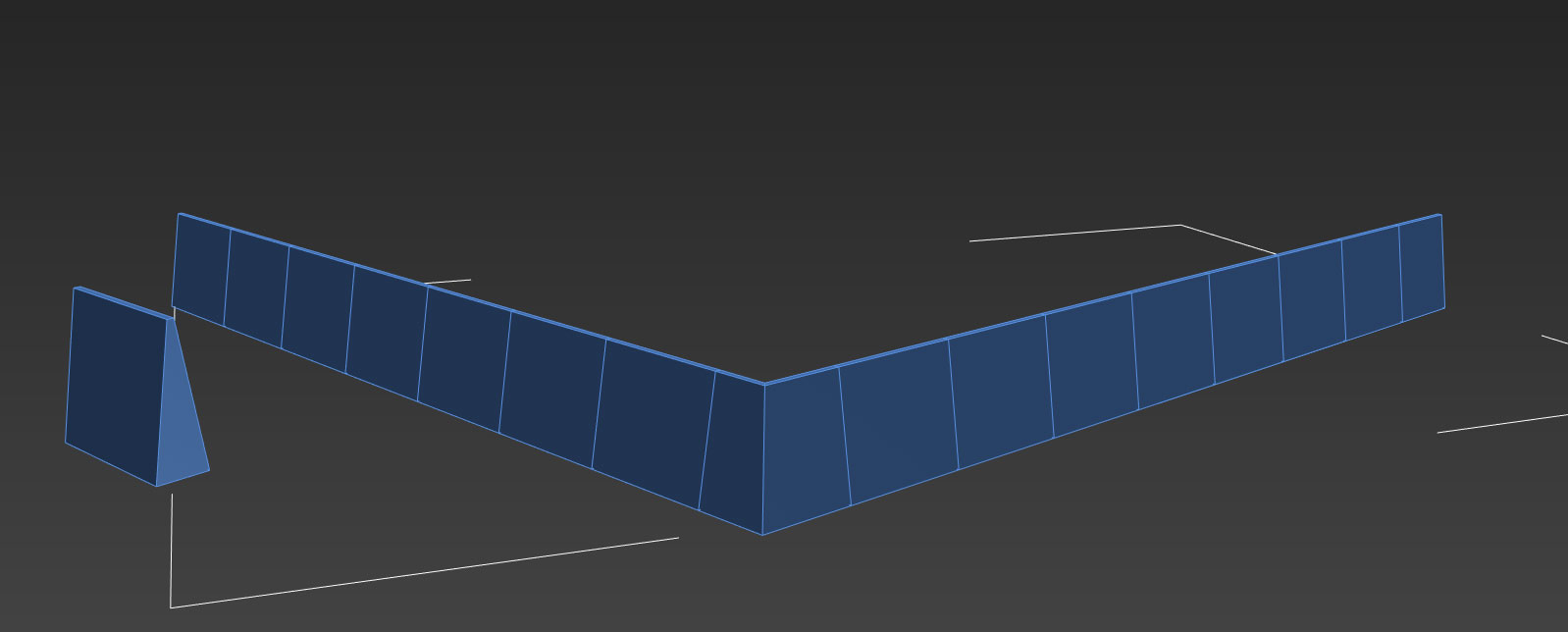

Here it is sweeping along a spline with one corner, as expected:

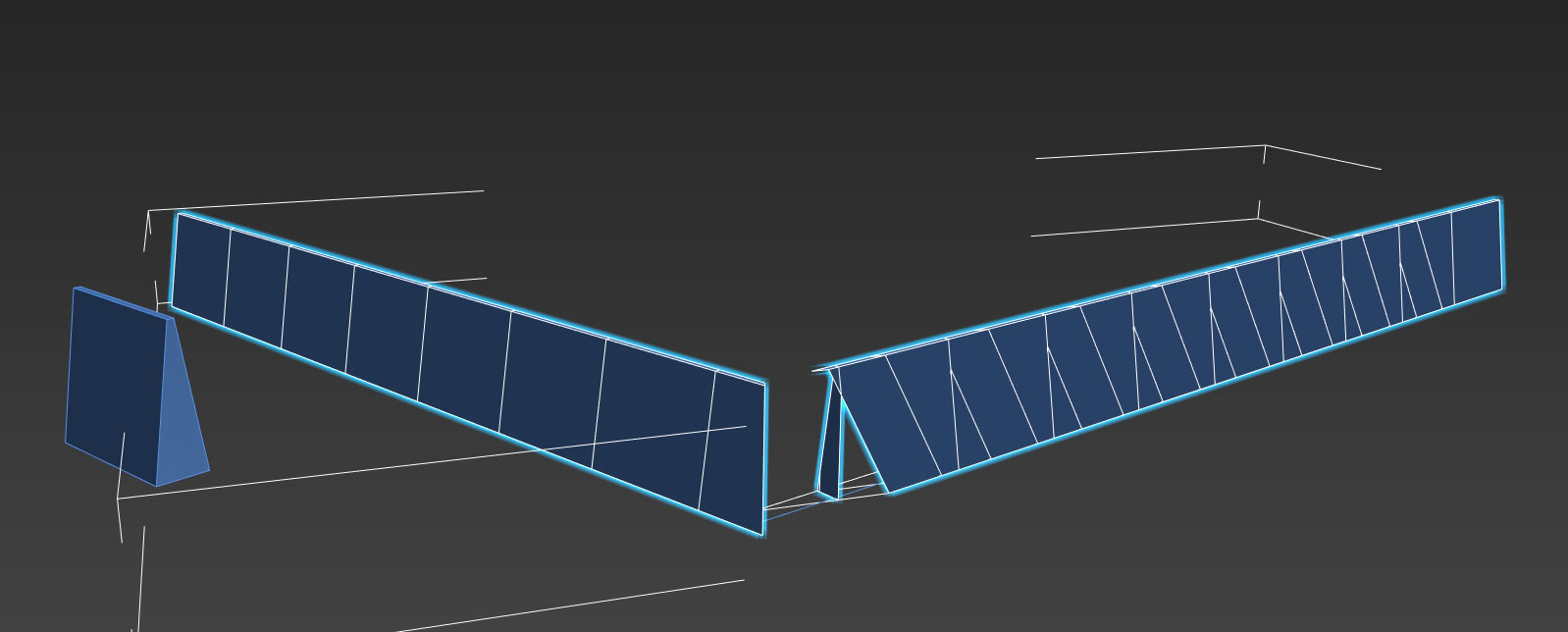

HOWEVER, if I divide one of those splines, adding several vertices without affecting it's overall vector, weird stuff happens:

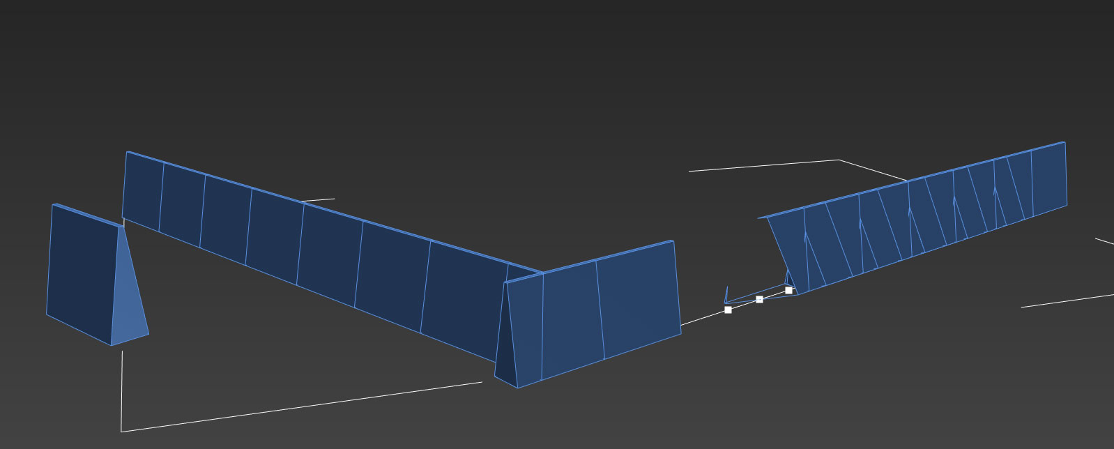

If I move one of the vertices just a tiny bit, so its angle does not equal exactly 180 degrees, the behavior returns to what is expected up to that vertex.  Any clue what's going on?  I'm attaching the scene as well, MAX 2016, vray 3.3, RC 2.6.

« Reply #1 on: April 13, 2016, 03:21:10 pm »
Hi,
Thanks for reporting this issue, I apologise for any inconvenience this is causing. I can reproduce the problem here and I've passed it onto our development team, hopefully it can be resolved quickly.
In the meantime you can get around this problem by making sure that the vertices along the path's length aren't seen by RailClone as a corner. To do this.
1.    Set the Rules > Corner Vertex Type to Corner.
2.    Changed all of the Vertices on the Base Spline to Corner-Beziers. Changed only vertices on a hard corner to the type Corner.

Thanks for your quick reply, Paul!  I'll give your workaround a try.  I also found that if I move every other vertex just a tiny bit, the issue is resolved since none of the angles are exactly 180 anymore.  Although then the segments aren't perfectly planar at that point,  in most cases it's not an issue for me.

Still don't work with "scale" RC i've to put it in "adaptative"mode to have a visibility.
If i let it to "scale" mode it won't work.
The definitive test is about a segment on my spline, that i "divide" to have the center.
Railclone let a free space beetween the (new)second vertex and the last third one...
La vie est une aventure dangereuse d'où personne n'est jamais sortie vivant.

I've done some test, it seems that's the symetric bevel mode that's cause the problem, with any other mode it work...
BUT!
If i want to play again with symmetric, i've to put the filet radius to a vlaue like 0.02, and it work again.
Hope it help!
