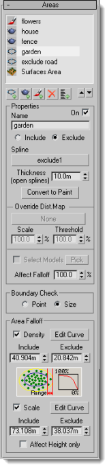

The Area panel has been completely rewritten. Now each Forest object can handle multiple areas, from three predefined types:
  * Spline. It works as in previous versions, including or excluding items from the area surrounded by the spline. You can use open or closed lines, which are detected automatically, replacing the old "Following Spline" parameter.
  * Geometric Object. It lets you to use any mesh as excluding area, removing items from the region occupied by the object. This type of area is optimized to work with high-poly objects in real time. Internally it works painting over a bitmap the mesh of the surface (as seen from the top view), and computing the distances to the items. Object areas use two parameters:
      "Top limit", is the limit of height in the mesh to which the exclusion is computed.
      "Map Size", defines the size of the internal bitmap (512 by default). You may increase it to improve the precision of the excluding process (usually when very large objects are used).
  * Paint Areas. Use them to add or remove items painting directly over the terrain. To difference to other painting tools, the Paint areas are editable and can be converted to splines and back. They can be used as "Include" or "Exclude" areas.
Regardless from their type, each area adds the following properties:
- "Include/Exclude" mode.
- Override Dist.Map. It lets you to modify the Distribution map, and adjust the Scale and Threshold values.
- Select Models. Use it to select the models (from the Geometry List) which are used in the area.
- Affect Falloff. Adjusts the strength of the falloff curves (Density and Scale).
Note: the order of the items in the list is significative: Exclusion areas have effect only to the areas below it.
